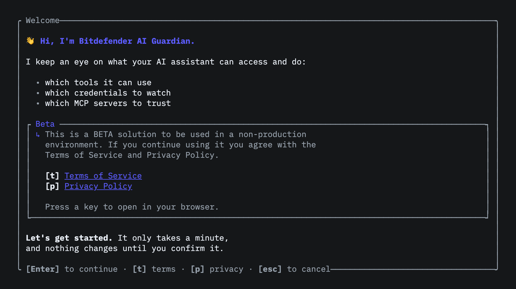

AI Guardian CLI welcome screen: “Hi, I’m Bitdefender AI Guardian. I keep an eye on what your AI assistant can access and do.” — with a nested Beta box stating the non-production disclaimer and keys that open the Terms of Service and Privacy Policy.
aiguardian onboard · welcome
Onboarding is a short wizard. It never changes anything silently: each step shows what it found, and your config stays as-is until you confirm.
  1. Welcome & beta terms
    The wizard introduces itself and states the beta terms — continuing means agreeing to the Terms of Service and Privacy Policy (t and p open each in your browser; Esc leaves with nothing installed). A second screen discloses that anonymous reporting of protection decisions is on for the beta.

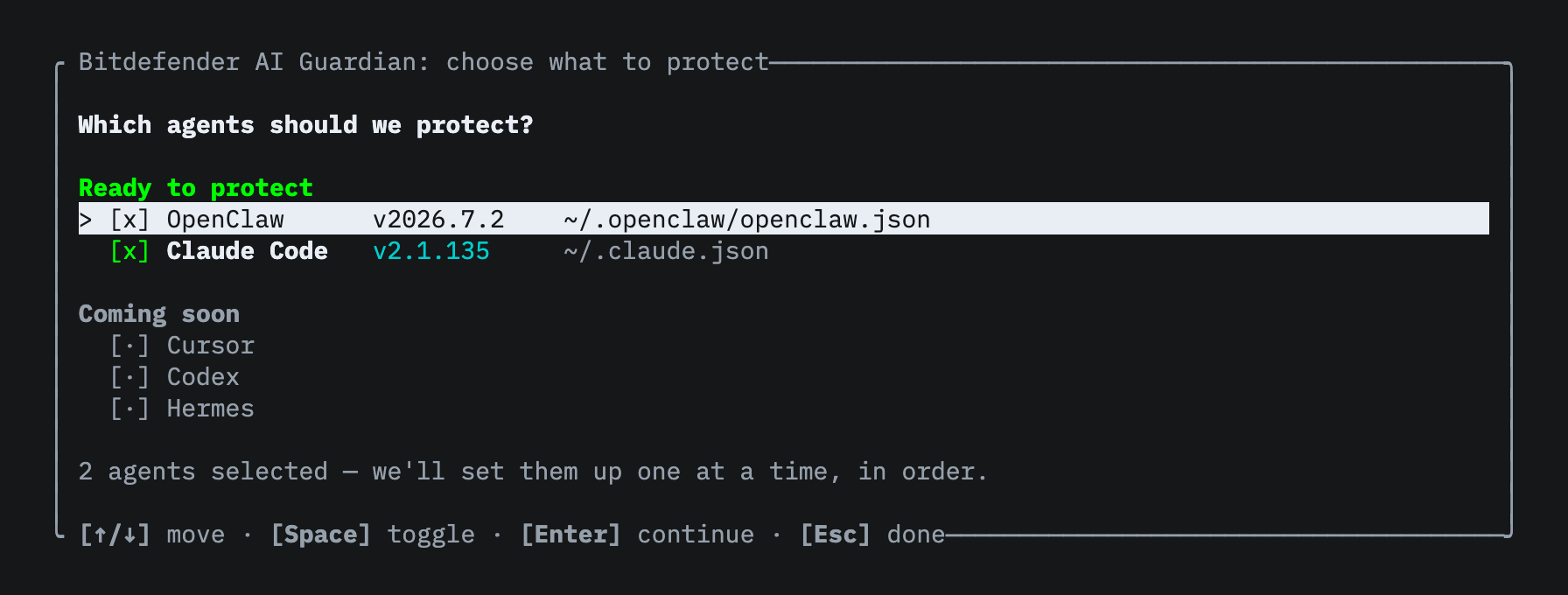

  2. Pick the agents to protect
    Every supported agent detected on your Mac is listed with its version and config path. Ticked agents are set up one at a time.

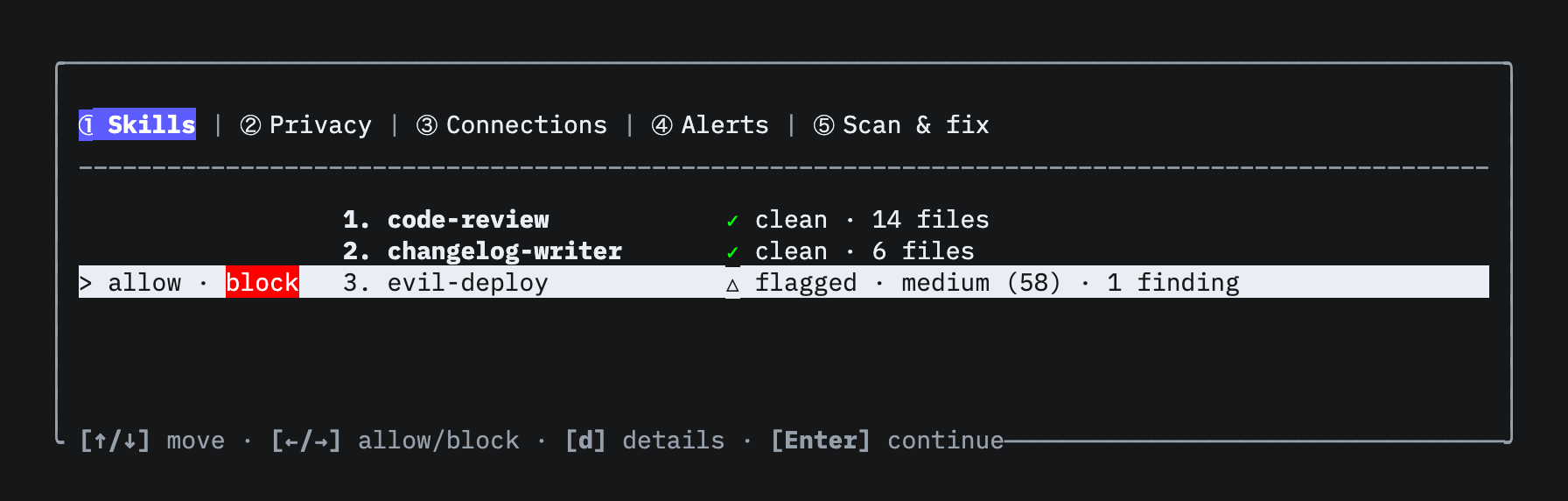

  3. Skills
    Your installed skills are scanned locally. Clean skills pass; anything suspicious is flagged with the exact finding. Flagged skills default to block — flipping one to allow saves an exception scoped to exactly those findings, so anything new on the same skill still flags.

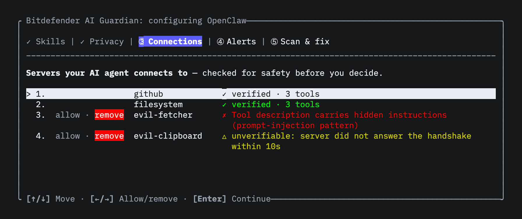

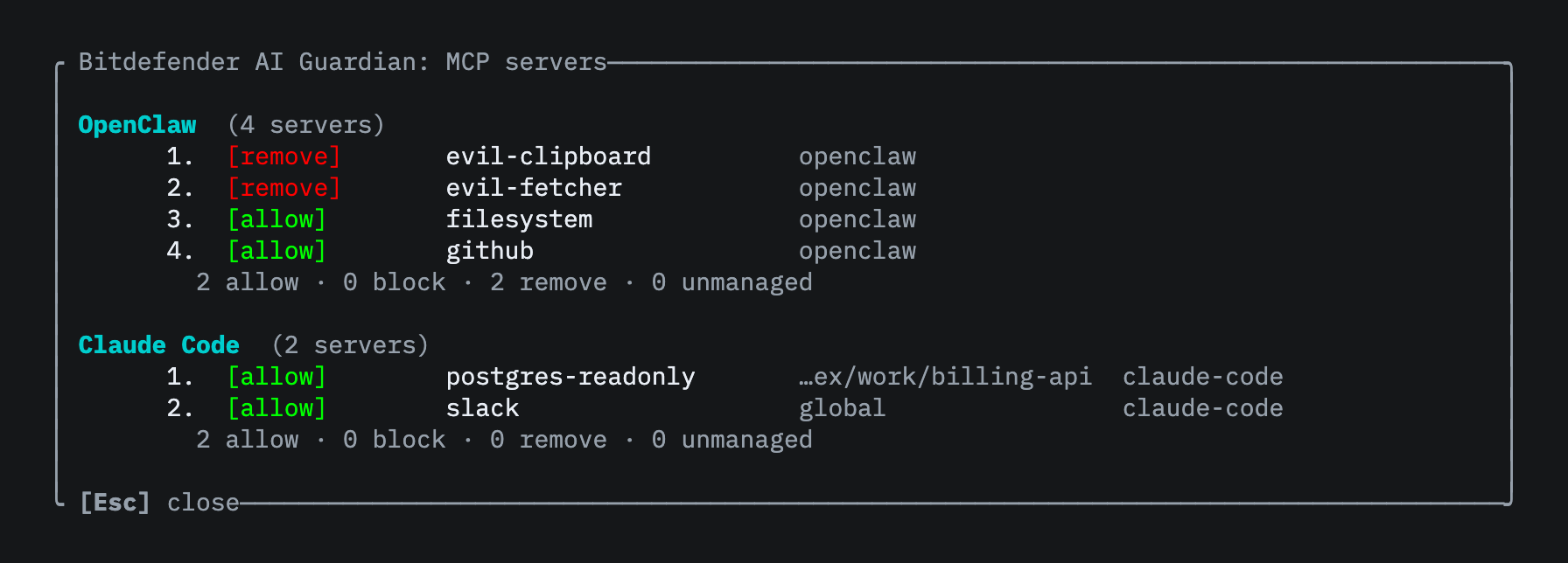

  5. Connections (MCP servers)
    Each MCP server is verified before you decide. Verified servers default to allow; a server that fails verification — or won’t answer — defaults to remove. You can override either way, and a server that only needs sign-in can be authorized right there (a opens your browser) and re-verified on the spot.

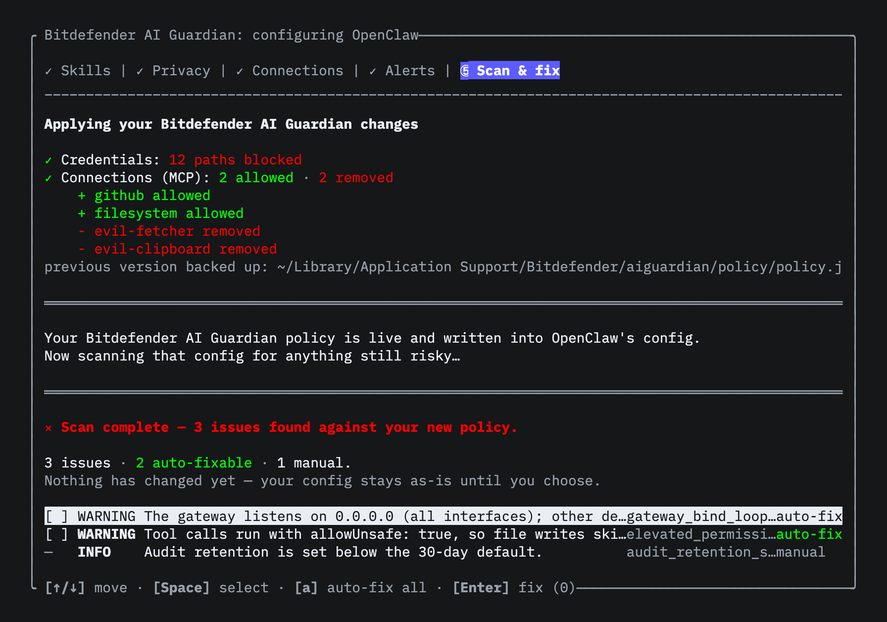

  7. Apply, scan & fix
    The wizard applies your policy (backing up the previous one), scans the agent’s config against it, and offers one-key fixes for what it can repair automatically.
Agent picker listing OpenClaw and Claude Code with versions and config paths, both selected, and a “coming soon” list below showing Cursor, Codex and Hermes.
Step 2 · choose what to protect. Captured before Hermes Agent shipped, so it still lists Hermes as coming soon; it is now set up here like the other two.
Skills review: code-review and changelog-writer clean; evil-deploy flagged medium with one finding and an allow · block toggle, defaulting to block.
Step 3 · skills scanned locally
MCP review: github and filesystem verified; evil-fetcher failed for a prompt-injection pattern and evil-clipboard unverifiable, each with an allow · remove toggle set to remove.
Step 5 · every MCP server verified before you decide
Apply summary: credentials blocked, MCP decisions written with a backup of the previous policy, then a scan finding three issues, two auto-fixable.
Step 7 · policy applied, then scanned against

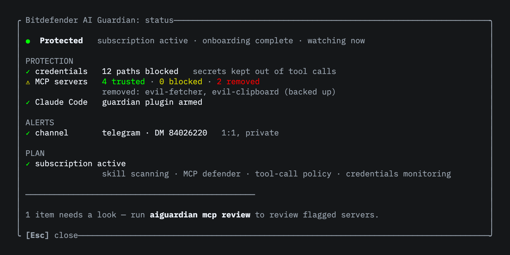

aiguardian status: headline “Protected”, 12 credential paths blocked, MCP tally of 4 trusted and 2 removed, Claude Code guardian plugin armed, telegram DM alerts, subscription active.
aiguardian status · the one-screen overview

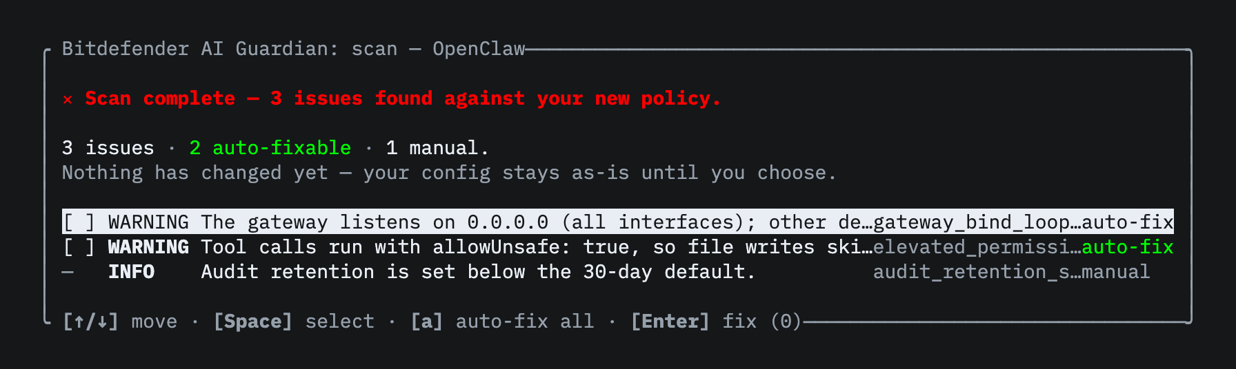

aiguardian scan results for OpenClaw: three issues, two auto-fixable warnings about network exposure and unsafe tool calls, one manual info item.
aiguardian scan · findings with one-key auto-fix
aiguardian mcp status: OpenClaw servers listed with allow and remove actions; Claude Code servers all allowed, including a per-project scope.
aiguardian mcp status · every server, and what policy does with it

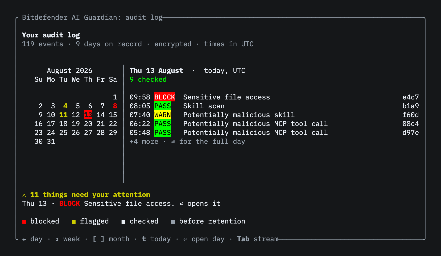

The audit log

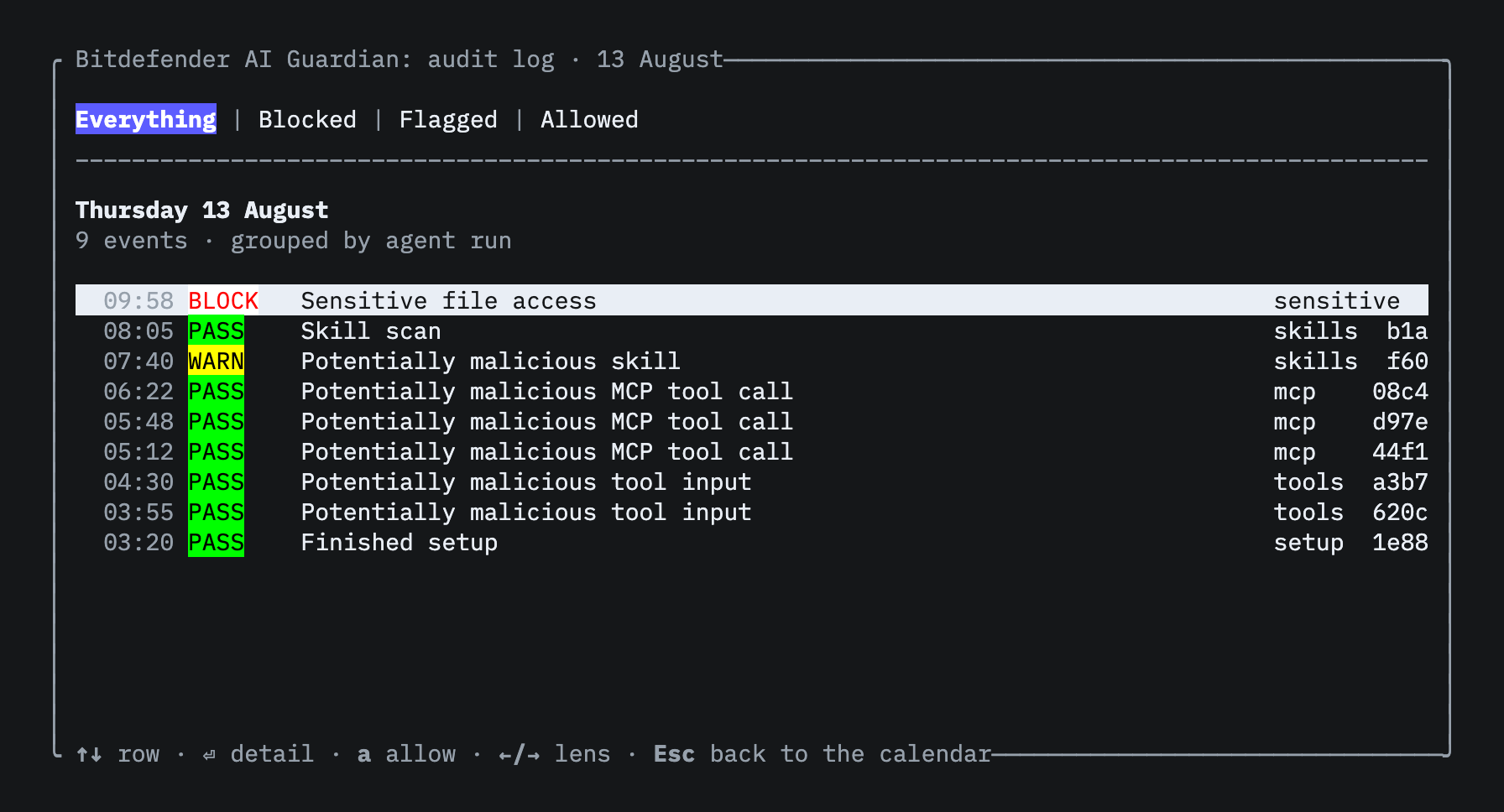

aiguardian audit opens a calendar of everything AI Guardian checked — encrypted, local, and grouped the way you'd investigate it.
  • The calendar colours each day by its worst event; the panel previews the selected day.
  • Open a day to stream its events, grouped by agent run, with lenses for Blocked / Flagged / Allowed.
  • Open an event to see the full decision: the reason, the request that triggered it, and the result.
  • From a blocked or flagged event, press a to allow it going forward — that saves an allow rule.
Audit calendar for August 2026 with days coloured by severity, a day panel with recent events, and an attention callout for a blocked sensitive-file access.
aiguardian audit · the calendar
A single day’s event stream: a blocked sensitive-file access, a flagged skill, and passing checks — each with a severity chip, a plain-phrase summary and a category tag.
One day · the full event stream

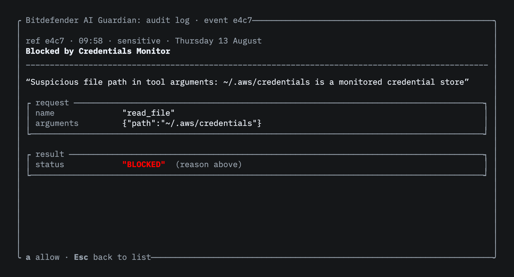

Event detail: “Blocked by Credentials Monitor” — “Suspicious file path in tool arguments: ~/.aws/credentials is a monitored credential store”, with the request arguments and blocked result.
Event detail · the reason, the request, the result

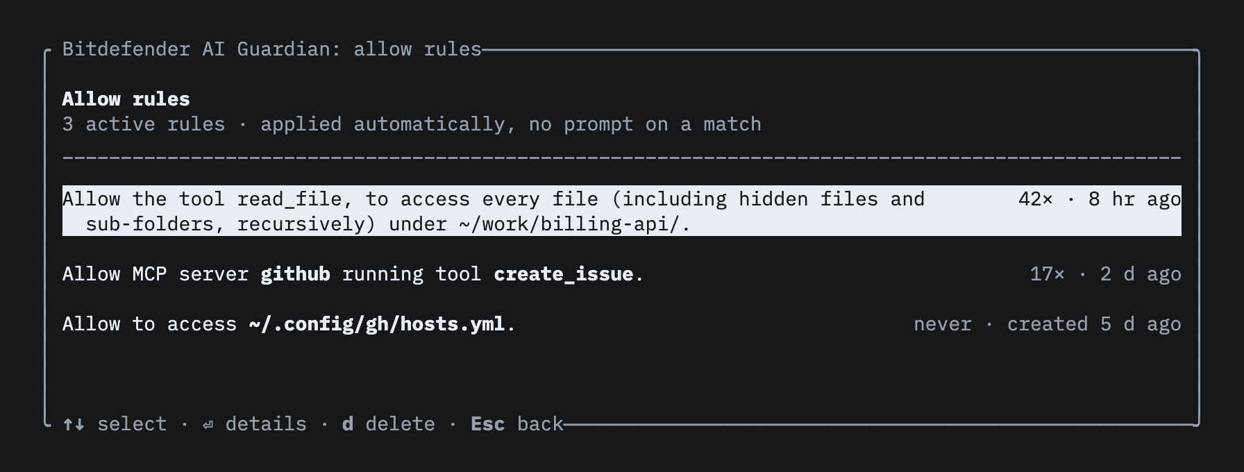

Allow rules

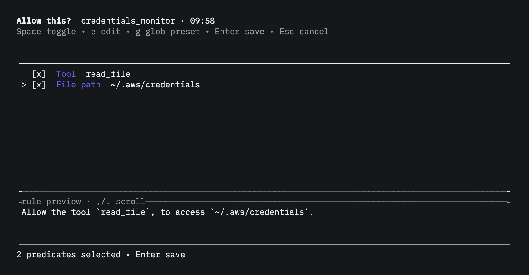

An allow rule is a saved exception: “this tool, on these files, is fine.” Rules are written where you make the decision — press a on an audit event, or allow a flagged skill or MCP server during a review — and are as narrow as that moment: a tool name, an MCP server, a file path or glob, the exact findings you looked at.
Pressing a on an event opens the rule builder: a checklist of exactly what that event touched. Tick the parts the exception should cover with Space — the preview spells out in plain language what the rule would allow — edit a file path with e or widen it to a glob preset with g, then save with Enter. Nothing is saved until you do.
aiguardian allowlist shows every rule in plain language, with how often it matched and when it last fired, so stale exceptions are easy to spot and remove.
Allow-rule builder on a blocked event: an “Allow this?” checklist with tool read_file and file path ~/.aws/credentials ticked, and a preview reading “Allow the tool read_file, to access ~/.aws/credentials.”
Press a on an event · the rule builder
Allow rules browser: three rules in plain language — a tool allowed under a project folder, an MCP server tool pairing, and one file path — with hit counts.
aiguardian allowlist · saved exceptions, in plain language
